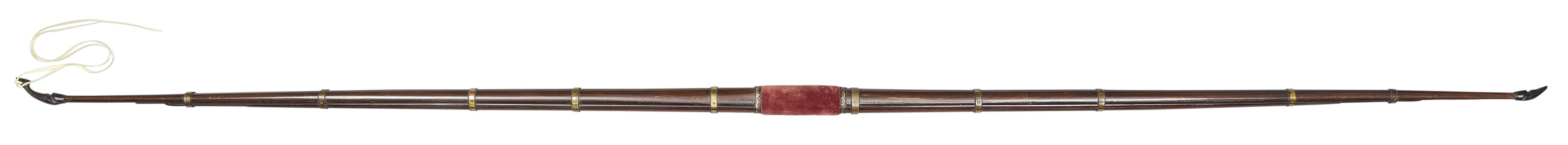

Tälläinen oli myynnissä. Lot 72. A very rare early laminated longbow, 18th century, with four layers of various dark woods, bound with ten copper alloy rings secured by nails, horn nocks, restored red cloth-covered grip (some small cracks in the bow and wear at the arrow passing point), 69 inches. Vasarahinta £220.
Tämä on hieno!

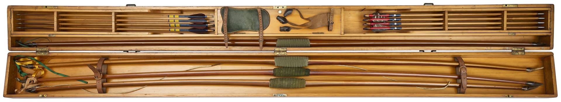

Lot 74. A cased set of four aldred longbows and two sets of arrows, late 19th/early 20th century, the first bow of yew, with 53# draw weight, horn nocks, inlaid arrow pass, green cloth-covered grip, stamped ‘Aldred London’ and ‘53’ with arrow markings, length 72 inches; the second similar, of yew, 50# draw weight, length 72 inches; the third similar, of lancewood, 30# draw weight, length 72 inches; the fourth similar, of yew, 54# draw weight, length 72 inches; the first set of six arrows 28 inches, painted blue with yellow bands and small arrowheads; the second set of eight arrows 25.5 inches, painted red with blue and white bands; the case marked ‘H.W.S’, with two folding arrow holders and a small compartment with a finger tab and bracer (restorations), 195.0 cm
Vasarahinta £700. Parin muun vastaavan setin vasarahinta oli £400.

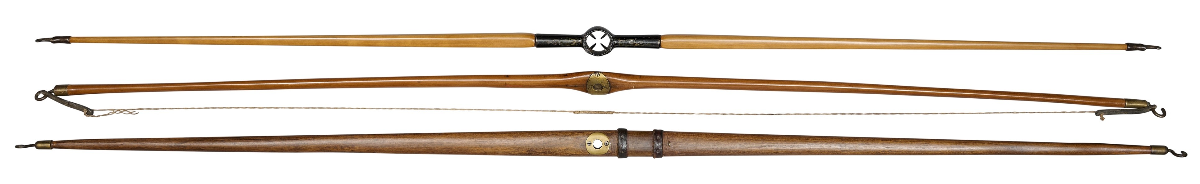

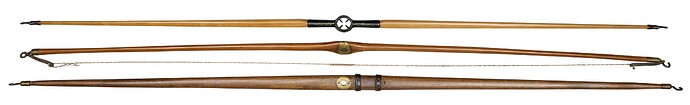

Lot 83. Three rare early centre-shot bows, 19th century, the first bow American, by W.H. Wright and G.L. Thorne, made of light wood, D-shaped section, iron grip painted black with circular opening for arrows, four blades within the circle to secure the arrow, faint painted scrollwork, stamped ‘pat.Mar.11, 1879 No. 5’, metallic nocks in the shape of longbow nocks (one cracked), 71.5 inches; the second of ovular section, swelling to an ovular grip pierced with a centre hole, reinforced with a brass plate on the belly secured by screws, hook-shaped brass nocks, with accompanying bowstring tipped with two leather tabs for securing to the hooks, 71.5 inches, the third similar, with flatbow section, two leather bands below the centre hole and a brass ring embedded below the bands (missing bowstring), 74 inches
William H. Wright, of Rochester, and George L. Thorne, of Buffalo, New York, filed one of the earliest patents for a centre-shot bow. They describe their invention in the patent as follows:
‘The object of our present invention is the production of a bow which is capable of being readily bisected for transportation and other purposes, and put together when wanted for use. Its object is, furthermore, to provide for a convenient guide for the arrow; and, lastly, to improve the construction of said arrow.’
The design was intended to be used alongside an arrow with hair or wire-cloth fletchings, which could better withstand being shot through the blades. The arrow was also weighted with an inner metallic rod near the point. For further information, see Patent US213083A (Wright and Thorne, 1879).
According to the late Bill Terry, the other two bows in this lot were reportedly used to cast telephone lines over obstacles and up slopes during the early stages of the introduction of the telephone. This would make them a similar age to Wright and Thorne’s bow, which is reinforced by their similar design.
Vasarahinta vain £160.

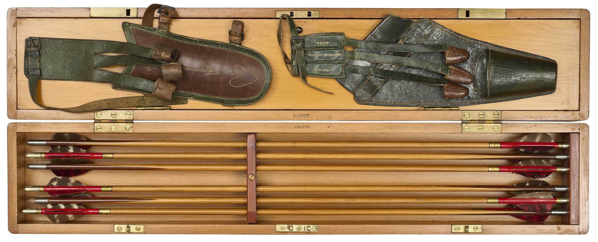

Olihan tuolla virheitäkin. Erityisesti tämä kohde, Lot 91:
“A fine Aldred cased arrow set with ladies archery tackle and scorecards, circa 1850
with twelve fine matched Aldred arrows, painted red with gold bands, aluminium nocks, 25 inches, (restorations) the case with a compartment containing a green leather heart-embroidered bracer marked ‘GA’ (for Georgina Abbs), a green leather ladies belt quiver with space for three arrows, two leather finger tabs, and two scorecards, one from the Grand National Archery Meeting in Exeter, 1858, the case 66.5cm”
Noissa nuolissa on kyllä alumiininokit (kuten muutamassa muussakin huutokaupan ihan 1900-luvun alun nuolisarjassa) mutta nuolet eivät tosiaankaan ole vuodelta 1858, vaan noin vuosilta 1908–1910. Jostakin syystä osassa nuolilaatikoiden sisäkansissa on tarra, jossa lukee, että “Aldred’s patent unbreakable aluminium nocks”. Nuolet ovat kyllä luultavasti Aldredin tekemiä mutta alumiininokin keksi englantilainen James Izzard 03.07.1907. Onkohan sitten Aldred ostanut Izzardin patentin? Aldredin nimissä ei löydy alumiininokkipatenttia noilta vuosilta tai aiemmin.

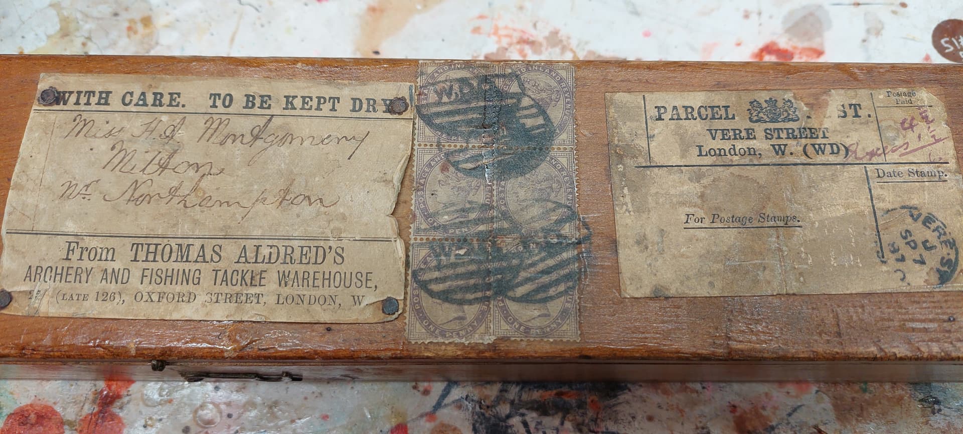

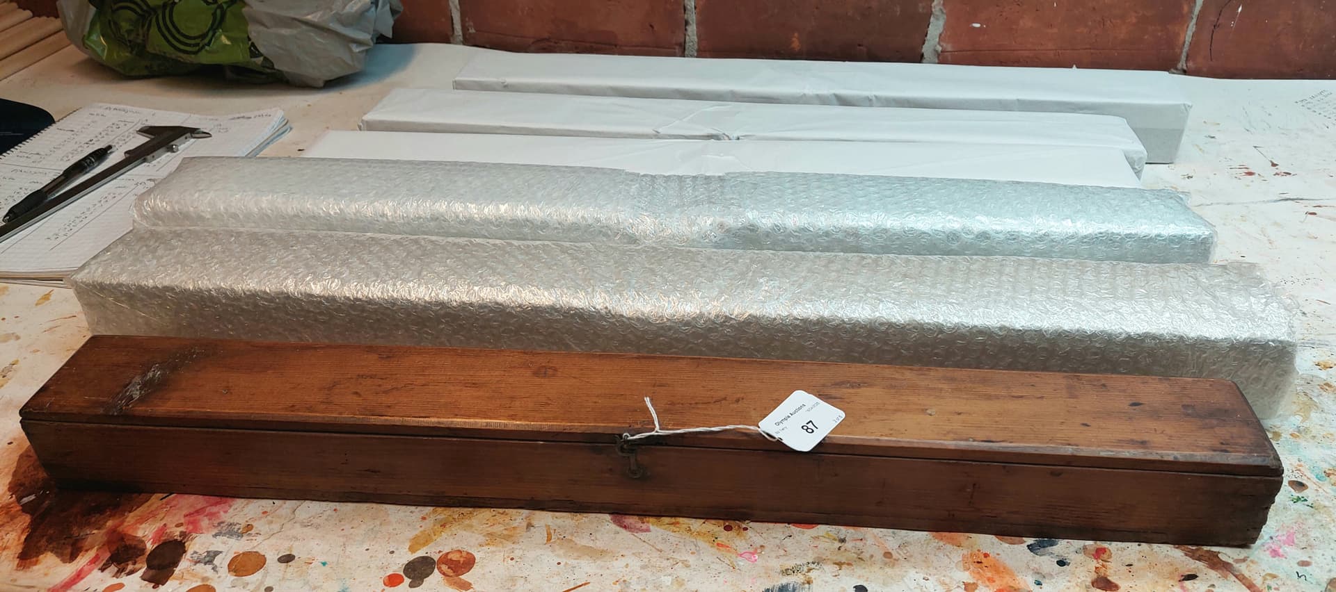

Eipä ole pitkään aikaan ollut näin jännittäviä paketteja!
Postimerkit lätkäisty suoran laatikon päälle. Ei saa leimoista valitettavasti päiväystä selville.

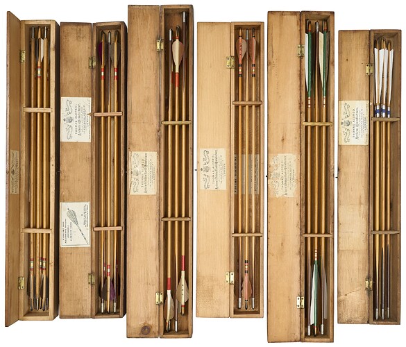

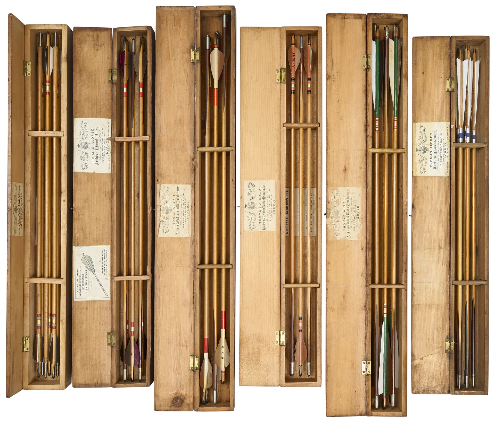

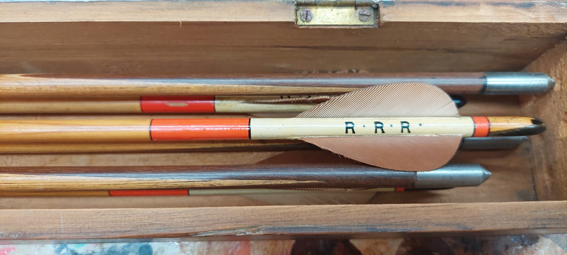

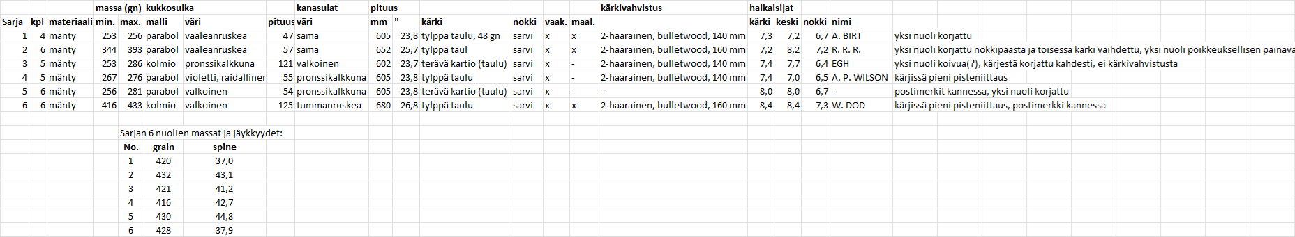

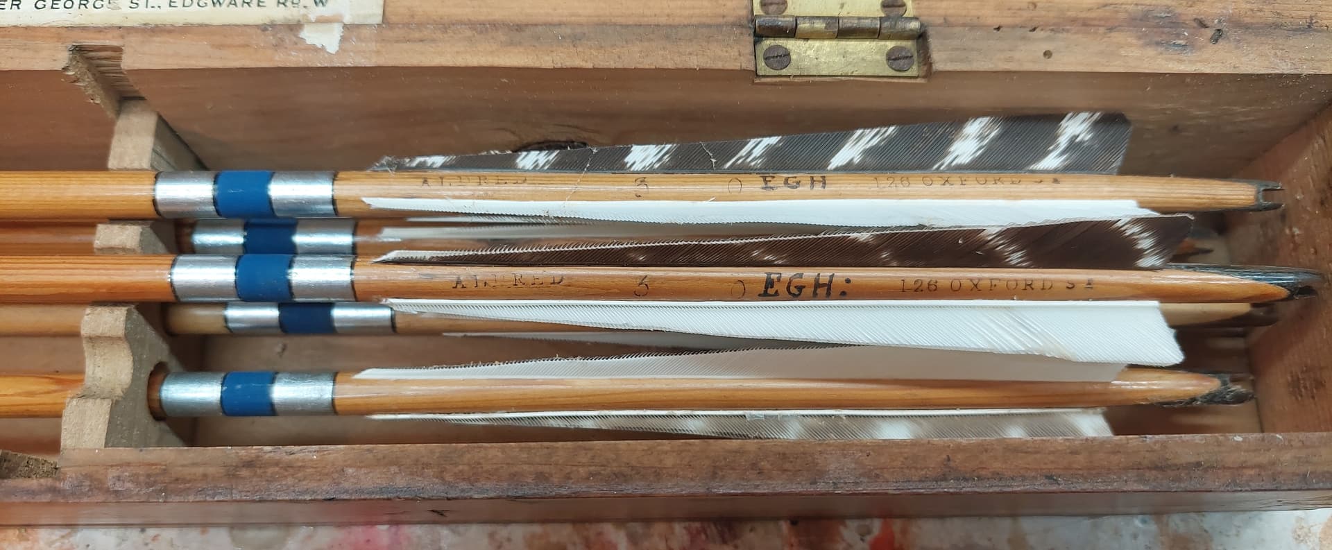

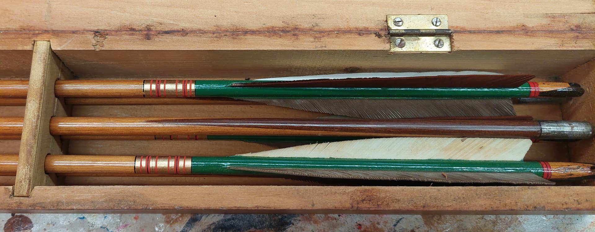

Tässä nuolien mittatietoja ja muita huomioita:

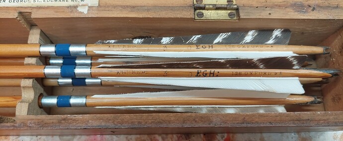

Nuolisarjan 6 sulitusta:

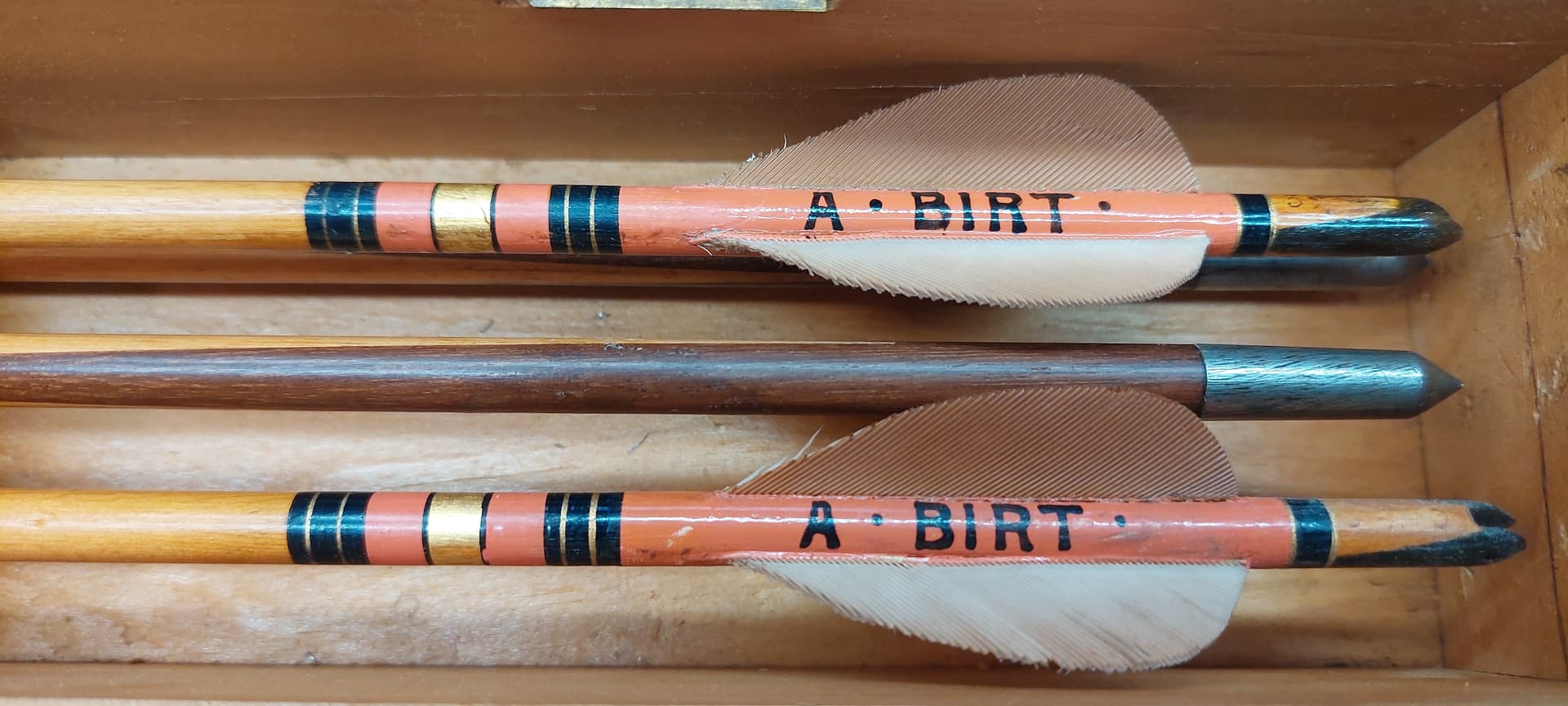

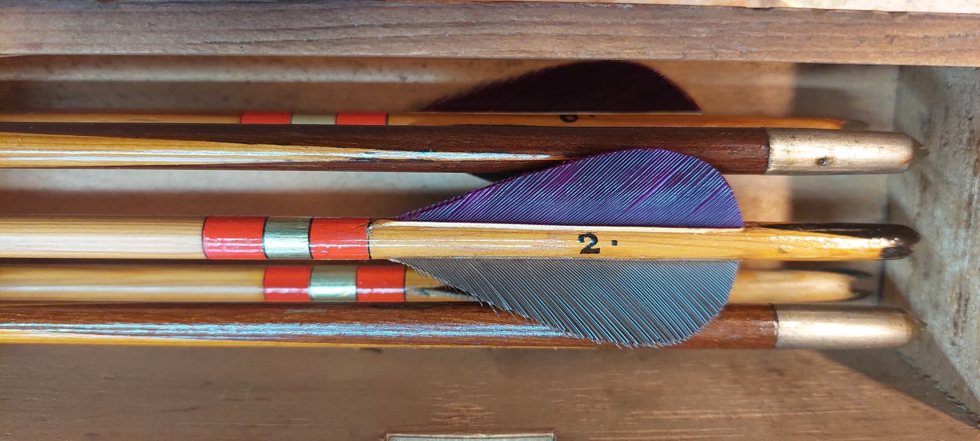

Nuolisarjan 4 nuolia. Näissä oli hienot violetit kukkosulat, oikein syvä violetti. Lisäksi näkyy kärjessä pieni “iskuniittaus”, lyöty kärjeen tuurnalla, niin ei pitäisi kärjen irrota niin helposti.
Nuolisarjan 1 sulitusta ja vaakunointia:
Nuolisarja 3 on hieno!

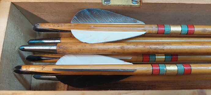

Nuolisarja 2 on aika perus.
Nuolisarja 5 oli ainoa, jossa ei ollut kärkivahvistusta.
